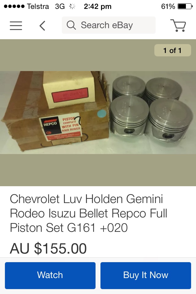

Check these Pistons out
eBay item no.271941108035

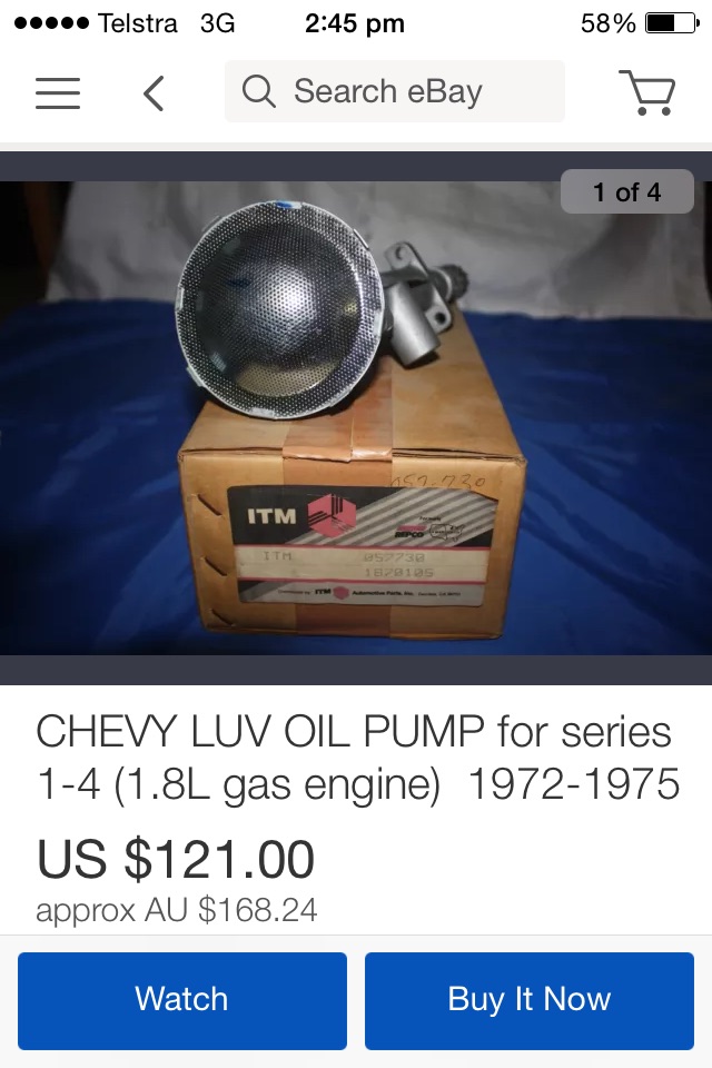

Also oil pump
EBay item no. 272054716902
Pretty sure this will fit
But it is listed for the 1800ss motor
J

Mon Nov 30, 2015 3:46 am
Posts: 57
Thanks James,
I have those Pistons saved in my watch list, might wait to see what mine are like first.
Managed to find crank bearings, rod bearings, cam bearings (hope these are the right ones), timing chain, std rings and already have a conversion gasket set as well as what can be borrowed from the above. So almost have everything I need on the way I think.
