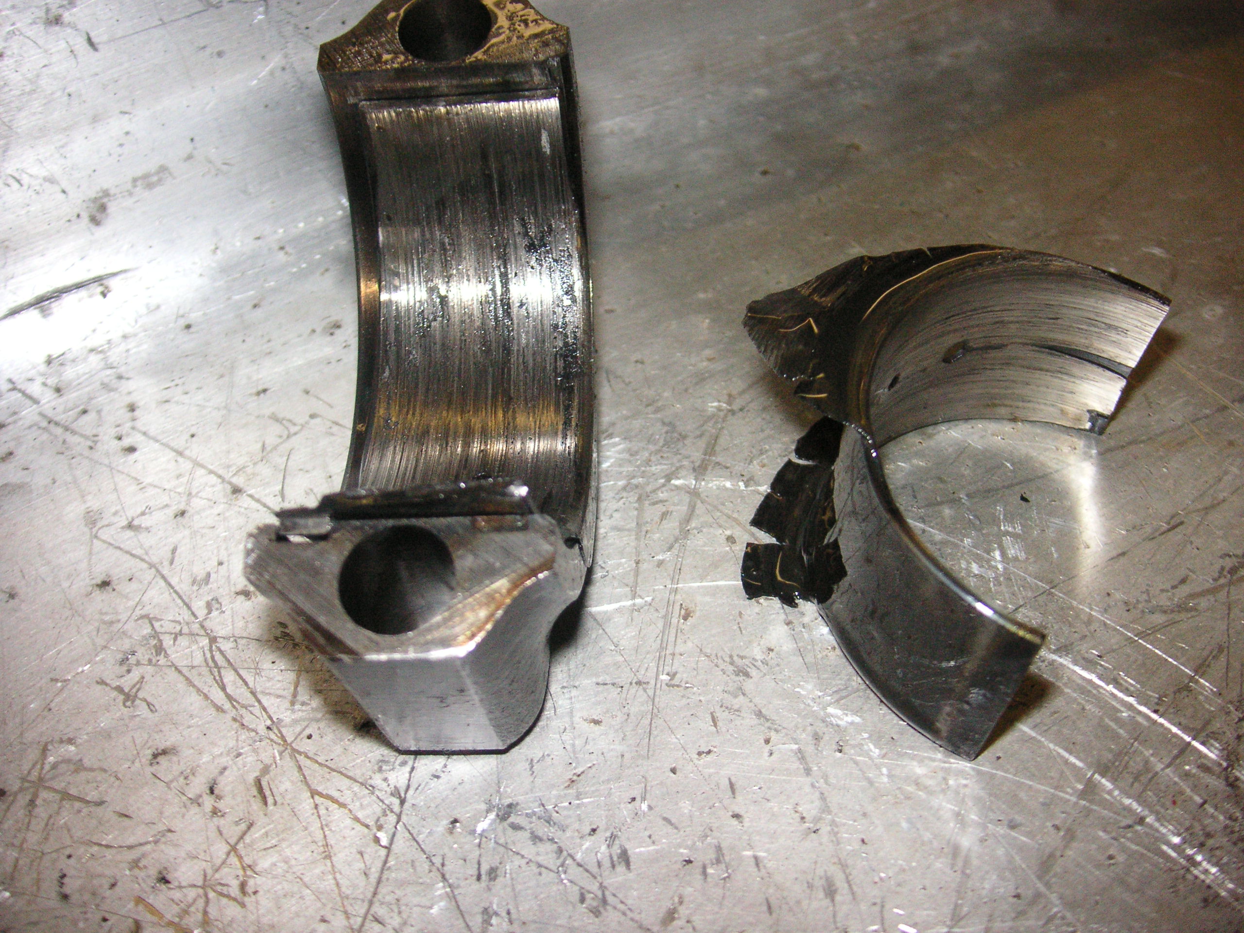

Back to earth with a bang...........six laps into qualifying, the dreaded death rattle. The car was absolutely flying, I was less than a second from last year's race pace, and I was still scrubbing in a new set of boots.
We reckon our stiffer front end has given us that little extra cornering speed, and surge has starved the bottom end. I'm told on good authority that if this happens, it's usually number 3 that goes....and guess what?
It's number 3.
In a warped 'racers' way, finding this has pleased me, as I was terrified of not knowing the cause of this end failure......at least we know what we have to do to prevent this from happening again.
So the planned winter engine build has just started a little earlier.
