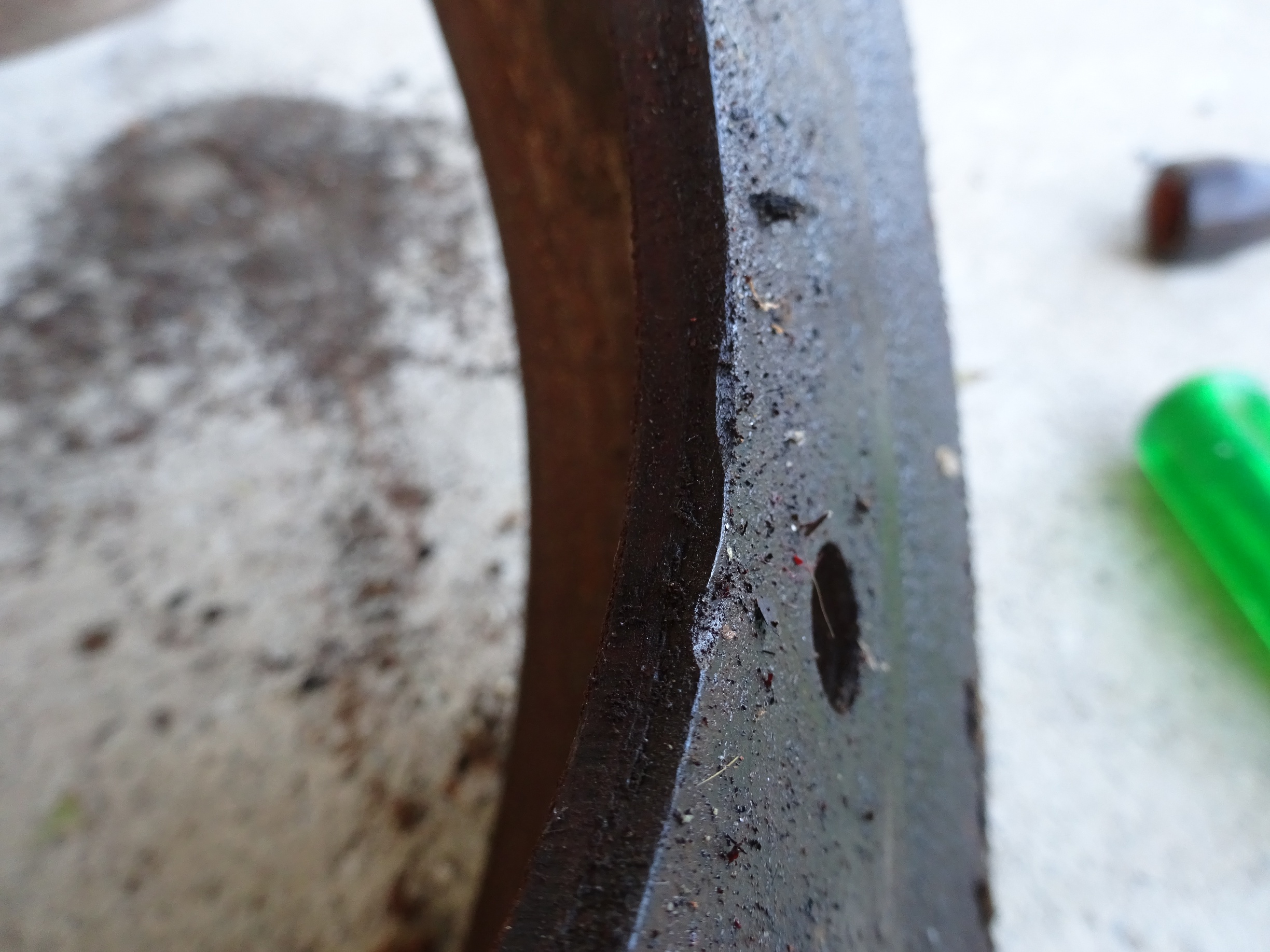

Been tackling the rear brakes today.
The rear RH side was pretty well seized up but with a bit of persuasion I got the drum loose enough to get to the adjuster cog so that I could wind back the shoes.
What I found once the drum was off wasn't pretty :oops:
I think it had been running metal on metal for quite some time as the steel body of the shoe itself is worn half way through and the drum has 2mm deep grooves across the whole face. So needless to say, the shoes and drum g straight to the pool room :lol:
Looks like new rear drums are on the shopping list

Sun Sep 10, 2017 1:30 am
Ahh mate, that is extreme! :shock: How loud would the squealing have been?
So, do you have any spare drums or shoes?
Yeah pulled a couple of decent drums with good shoes off the Tingha ute today + I have a pair of new drums and shoes for the front and cylinders for the rear arriving sometime this week.
Still can't get rear left drum off but will give it another shot tomorrow after work.

Rear shoes weren't as bad as the other side but they were definitely on their last shreds too

Thanks for the pics. Centre of drum to axle face would have been the problem. Very little tolerance in that area.
Had a sedan rear with same problem. Not only damaged the backing plate. Had to use a large drift to get the drum to move. Hence a few small chips to the outer of the drum. :|
