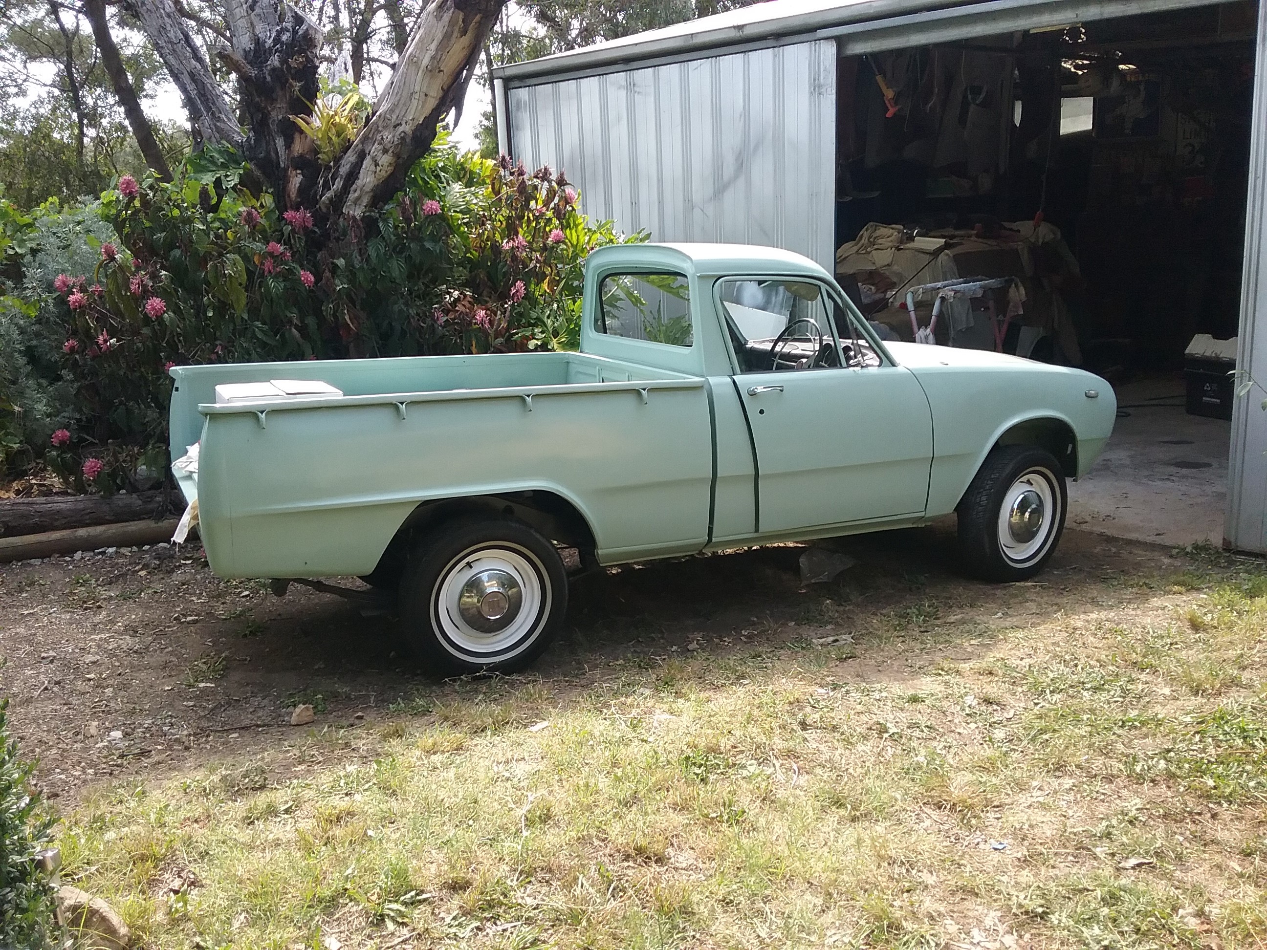

Fri Oct 20, 2017 11:59 am
Posts: 83
Location: Kilsyth , Melbourne
Car(s): see user name
Hello all ! I have had a productive couple of weeks in my garage . I always get a good feeling when the end is in sight . The wasp is painted , engine & gearbox is in , wiring going in now , grill & rims sandblasted & painted , dashboard cover stolen from wrecked rally car & lots of cleaning , polishing & painting . The worst & most time consuming job is trying to find things I removed 10-15 years ago .
