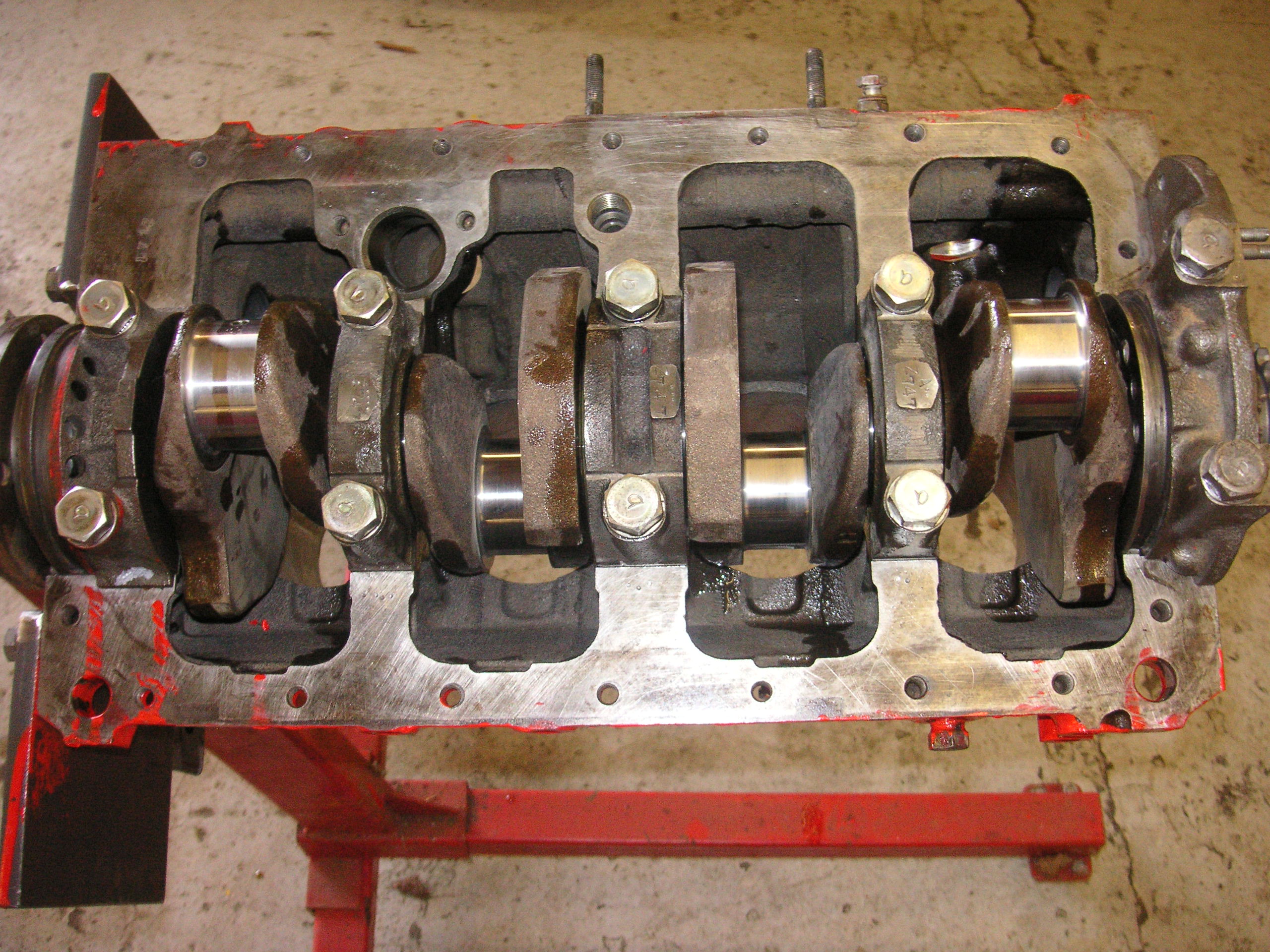

OK Rolie fans...the block is back, the crank, flywheel and clutch are balanced.
And we've splashed Sticky's favourite 'go faster' super quick paint all over the place.
My 'aero' spec rods don't match the gudgeon pins, so there's a little extra work to be done there, but otherwise we're on schedule...........good grief, did I really just say that?!
