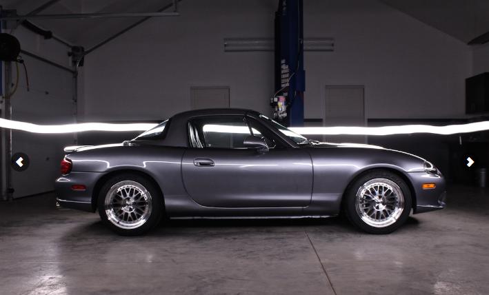

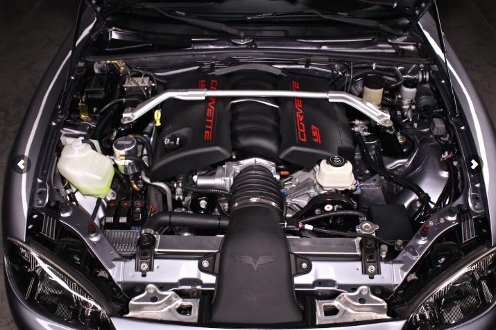

There's been talk in the past here of putting an MX5 engine into a Bellett.
Here's almost the opposite....... a Corvette LS3 v8 of 525hp into a MX-5.
This is a very professional high dollar job, all new parts etc. Interesting part is that the front to rear balance is almost unaltered from the original engine.
http://www.v8mazda.com/photo_video_updates.html

Manic! That would require traction control I reckon, or a front diff!
:o Matt.
Sat Dec 22, 2018 10:18 pm
:o Matt.
Not sure if the MX5 has any electronic traction aids but the guy put everything back that it had. The rear end was replaced with 3.43 diff from a Cadillac CTS i think it is. Plus a kit to fit that. Front end is a tubular adapter. Has coil overs all round and plenty of trick stuff. 0-100k in 4.1, standing 1/4 in low 11's. He doesn't seem to indicate there are any traction issues.
Appears he was given most of the stuff by Summit racing who make kits for various implants into MX5. It actually started out as a turbo'd MX5.
