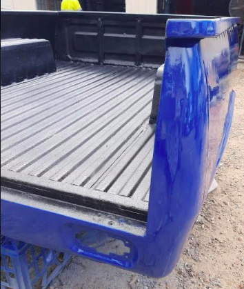

Last evidence of the Reston yellow wasp. Tub finished. Reassembly will begin soon.

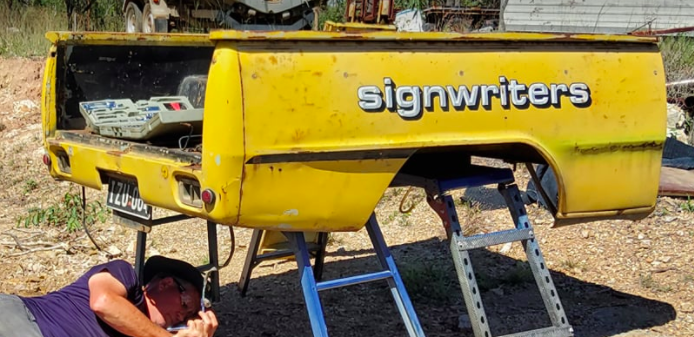

Last of the yellow

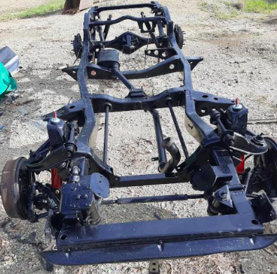

Chassis - 3.9 dif exhaust, rear brakes & lines, handbrake cable done.

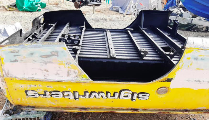

Undercoating.

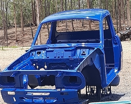

Cab - ready for some reassembly.

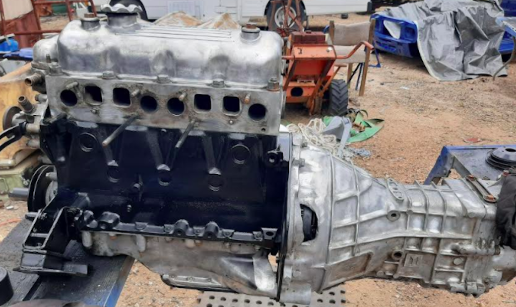

Been cleaning the engine and transmission - painted the block in original black and cleaned up allt the alloy bits. Brakes all sorted - front drums required new cylinders and drum turned - one side almost down to metal to metal. Need to patch where "someone" cut out a section of the bell housing to accommodate a Rodeo started. Good that I had a near new original starter to go back in. Between me and my engineer we determine that there would have been 4 or 5 different people "modifying" different parts of this Wasp that required serious repairs to make it close ot original. This has not been an inexpensive restoration project and is not a surprise to keep this Wasp from the scrap yard. No regrets but maybe the next owner will appreciate the painstaking time we spent getting this done properly. And no it will not be for sale - I intend to drive it.

Nice work. Well done.
I recall seeing a Bellett with the bell housing cut like that many years back, to fit a Gemini box I think.
Curious why you need an engineer?
