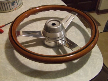

Todays update is about steering wheels and bosses.
I bought an RX Mazda type steering wheel boss and while the spline is okay it sits nowhere near the right spot, have to modify the horn contact ring quite severely to get it to fit : (
Am also going to make my own steering wheel spacer using the bought boss and old steering wheel to get a better distance to the driver (me).
Also finally managed to win a steering wheel on fleabay, took 5 trys to get the wheel I wanted and then had to settled for a 33cm one instead of 36cm, still it should look pretty cool once I finished the custom horn button. (Pictures when complete).

rob, which RX mazda is it suited to?
reason i ask is coz there are different length ones with the same spline, so u might be better off with the deeper boss of u have the shallow one.
shallow one is off a series 1 RX7.
deep one is off a RX4.
also, the horn ring is a common prob.
i solve it by using an indicator stalk off a Mini, and wiring the horn to the push-end of the stalk (like XD-E-F Falcons were done).
cheers.
Tue Jul 27, 2010 8:29 am
Hi Brett
We used a series 1 rx7 on a 67 gt no problems bolt on fitment with no modifications.As you would know later gt's had a differant spline i have not sourced one yet for our yellow car.
As for walter [WASP] he got a rx series 1 also,but we needed to move the indicator stalk down towards the fire wall about 5mm.The roller fould for the horn.We did not have to modify the casing.The only problem was the self canceling needed tabs towards the steering wheel.
Tue Jul 27, 2010 8:42 am
greg, yep, the later spline is different.
use a Gemini boss on them. perfect fit.
i made mention of the RX4 unit as this might save rob making a spacer to bring the wheel closer to him.
i put a series 1 RX7 in my Wasp too.
i also did some mods to make the whole thing sit closer to the dash too, as the seats i have in it put your backside about 3-4 inches closer to the wheel, and a Wasp is cramped enuf without any help!
being over 6' tall doesnt help either :lol:

I got one which is supposed to fit RX2,3,4,7 and miata, it was cheap and I think that is where the problem lies.
The boss without the horn ring sits way down, wasn't sure how to move the horn floppy wheelie thing and to be honest it's already to far away (indicator stalk) from me as it is.
I can use the boss I bought but I'm not happy with it and if all Mazda ones have a problem with the horn contact, I'll do some more modifying rather than buy a dearer one which will still have the contact issue.
I guess it boils down to the fact I want to make a GT style horn button, though not a GT horn button (we'll call it a GTS horn button). Still using the original stuff from the sedan.
Really it's not such a big deal as I'm an ex-Fitter and Turner, just that the closest friends lathe I can borrow is hour and half away and usually ends up a whole day (we get talking cars and time ... well).
By the way thanks for the heads up on the contact I thought I had got the wrong one.
I'm a bit nervous waiting for my steering wheel to arrive, I hope it's going to look as good as I think it is !!! :? :)
Tue Jul 27, 2010 11:38 am
when i do mine rob, i leave the ISUZU horn button in place and just make the horn work as described on the end of the indicator stalk.
also, the normal sedan ISUZU centre piece from the standard horn ring is removable, and is i neat fit on most aftermarket horn buttons, with some superglue to hold it there. looks very GT-ish when done like that too, especially if you use a red button horn instead of a white one.

Update on steering wheel and adapter.
A sneak peek on progress so far.

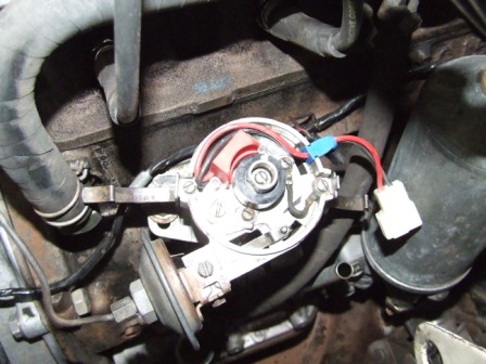

In last month's episode ... trouble with distributor.
In today's episode ... trouble with all three distributor's :(
Not a single one of the three distributor's has a full set of mechanical advance springs. the one distributor I thought was okay but had a dodgey vacuum advance mechanism wasn't so okay.
The dodgey vacuum advance was due to one of the mechanical advance weight springs making it's way up to the top and jamming the vacuum advance arm against the distributor body !!??
In not seeing this earlier I have pulled the carburetor apart four times, cleaned it out two times, checked the fuel pump, broke and fixed the throttle cable, replaced the rotor button and distributor cap, including buying spares, reset the ignition timing five times and lastly replaced the stock coil with a GT40 coil just to make sure that wasn't the problem ... aaarrrggghhhhhhhhh :(
In the next episode ... pull an old Falcon distributor apart raid the counterweight springs, put one distributor back together and hope it works well enough that the car will run and I can set the idle and mixtures !!!

Hmmm .... read tag line again.
Seems I may have an electrical problem.
First picture is of what is left of the Bellett mechanical advance springs from THREE distributors ! :shock:
So pirated some from an XE distributor.
After cleaning, new mechanical advance springs and checking everything.
This is what I put back into Bella.
Guess what, she no run !? :(
No spark.
My guess is that somewhere in the wiring is my problem. Tomorrow is "chase a fault in the wiring".
The one thing I'm really not that good at .... AND DISLIKE.
Thanks mate.
I'm pretty sure that the problem isn't in the distributor now, just have to find which side of the coil the problem lies.
"Have to charge battery again" :(

Not a problem Mr B.
for others, engine mount and rack done at same time by jacking engine up with piece of wood under the sump.
If you don't the rack's concertina's catch on the sump fins and won't slide in or out.
Wiring turned out to be a wire that had pulled loose when I was mucking about with my race tacho.
The carburetor problem was a float set too low.
and of course you've all seen the distributor problem.
Had to sneak up on the tune as one thing needed to be fixed and adjusted to get the next increment on each :(
Hot-spark electronic points conversion is fitted and working (that's what the GT40 coil is for, has to have minimum 1.5 ohms primary resistance).
Engine seems to have lost it's intermittent miss at idle as well !?
