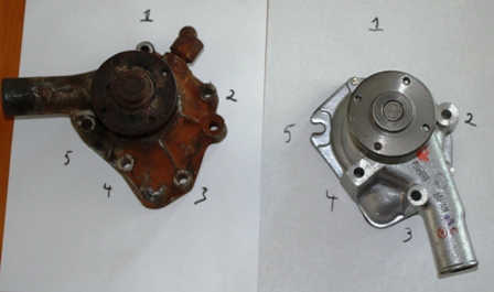

This is both pumps side by side
File comment: Both pumps side by side
Doug Hillmer
Sun Aug 19, 2012 11:49 pm

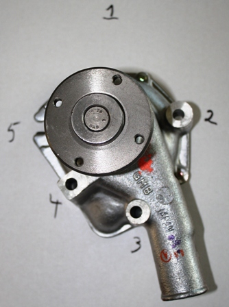

This is a closer up of the original Bellett pump.
One thing to note is that between holes 2 and 3 in the picture there is another hole.
On my engine there is no bolt in that hole. I mention this because on the LUV pump (next picture) there is no hole there.
File comment: Original pump off 65 Bellett
Doug Hillmer
Sun Aug 19, 2012 11:52 pm

Here is the LUV pump. (Bomba de LUV in spanish, has a nice sound to it :)
Note the direction of the outlet.
Also note that hole 1 does not exist.
That may be the real sticky point, but I think it could fit still.
File comment: New pump for 72 LUV
Doug Hillmer
Sun Aug 19, 2012 11:54 pm

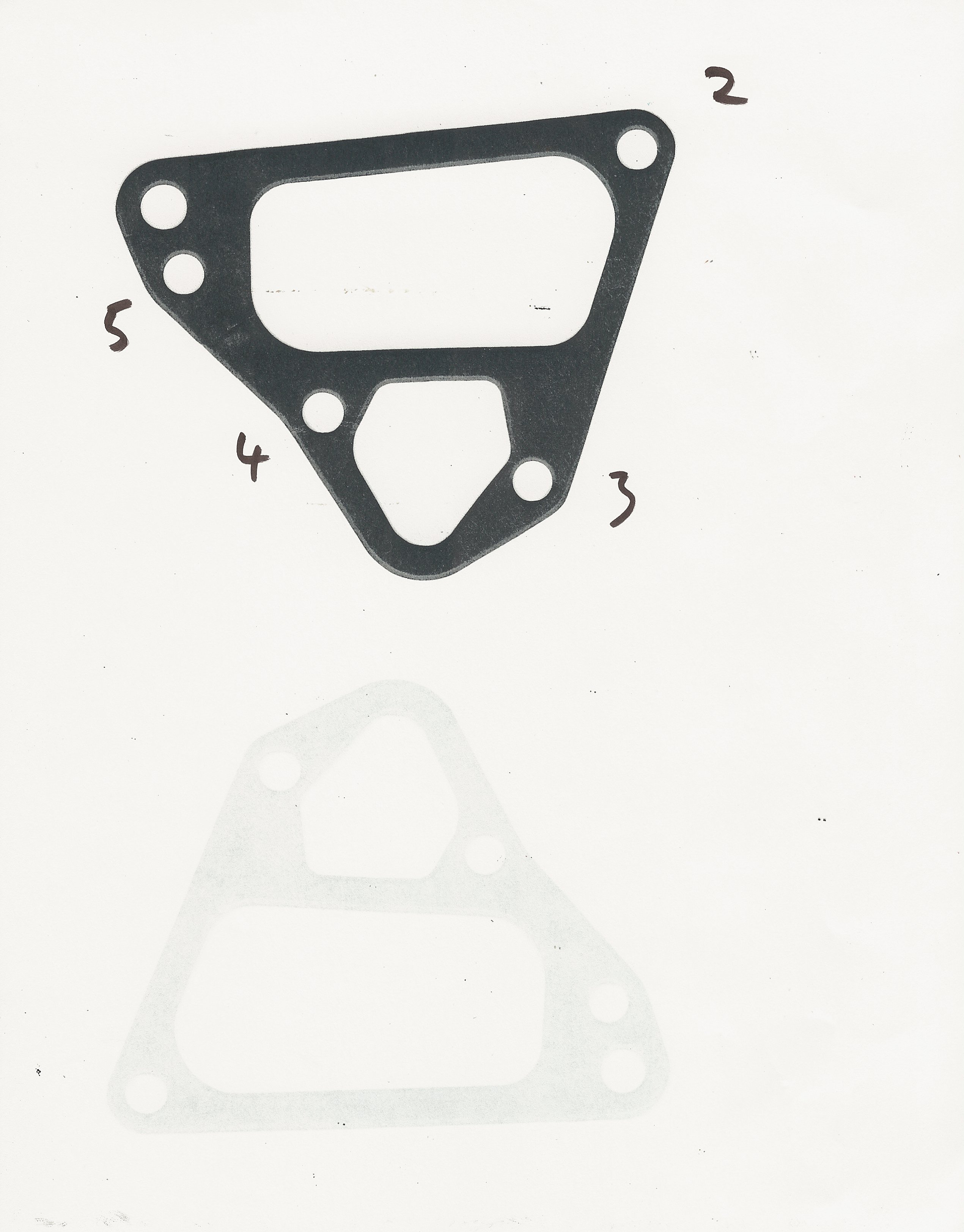

One last picture here, there was a gasket that came with the new one.
I scanned a copy of it and hopefully this will come out as actual size
(print on 8.5x11 paper).
File comment: New LUV gasket
Doug Hillmer

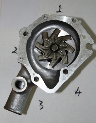

Here is the backside of the original Bellett pump.
File comment: Backside of original Bellett pump
Doug Hillmer

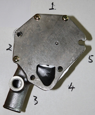

Here is the backside of the LUV pump, notice it has a plate screwed on.
File comment: Backside of LUV pump with plate
Doug Hillmer
Mon Aug 20, 2012 12:24 am
Posts: 36
This is the backside of the LUV pump with the plate removed.
File comment: Backside of lUV with plate removed
Doug Hillmer
