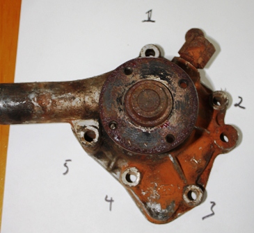

Posts: 36
This is a closer up of the original Bellett pump.
One thing to note is that between holes 2 and 3 in the picture there is another hole.
On my engine there is no bolt in that hole. I mention this because on the LUV pump (next picture) there is no hole there.

I have a chev LUV water pump also here (at home that is) but it has a boss on the back area of the water outlet i think. Can't recall if Bellett has that also.?

Looks like 1800 sohc water pump to me :?:
