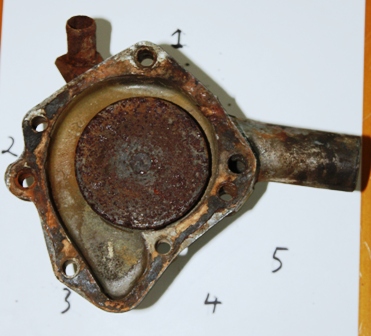

Posts: 36
This is a closer up of the original Bellett pump.
One thing to note is that between holes 2 and 3 in the picture there is another hole.
On my engine there is no bolt in that hole. I mention this because on the LUV pump (next picture) there is no hole there.

I have a chev LUV water pump also here (at home that is) but it has a boss on the back area of the water outlet i think. Can't recall if Bellett has that also.?

I had realized I also should have taken pictures of the backside.
While Glenn was busy replying, I was doing that.
Yes there is a hole in the backside of the outlet that would need to be plugged.
I suspect you could find or make something to screw in that would plug it.
(see pictures to follow).

Looks like 1800 sohc water pump to me :?:
Mon Aug 20, 2012 9:15 am
ala Chev Luv. I bought one the same recently off ebay.
Mon Aug 20, 2012 9:49 am
thanks for all your help there, Doug.
may be able to use internal bearings and seals to repair the original Bellett pumps.
worth it for a job lot.
cheers
Mon Aug 20, 2012 10:49 am
That was the pump I was looking at for the OHC motor sitting in the shed Oz.
Maybe I'll have to owe you money for two pumps :shock:
