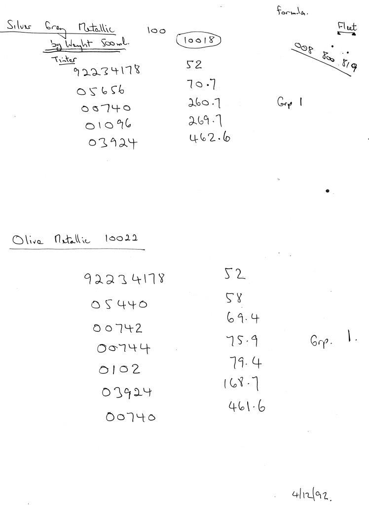

This is later information, in late 1992.
The tinter names were current then but I don't know about now. Dulon acrylic colours. 1st column is tinter number, second column is the amount of paint to make up 500ml of paint.
Silver grey metallic is what my GT was (now Dave's car).

Thanks for the tinter names and proportions
I have been looking for them for some time

No problem, hope it's helps
