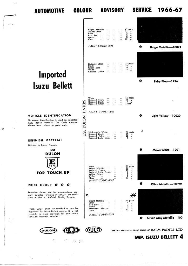

PAINT COLOUR MIXING
This is a very old colour chart with paint mixing details.
It may not be valid with up to date colour pigments but a good paint shop might be able to help.
I have some more info, just trying to dig it out.

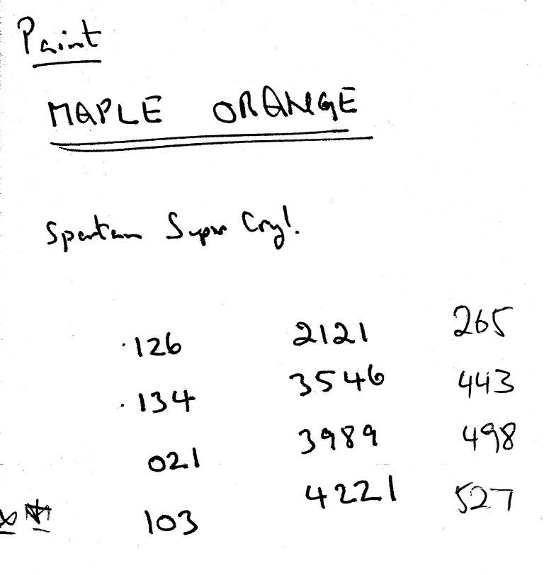

OK found another..... I think this is the GTR style orange.
Have no idea what all the numbers mean though. Paint shop might help again here.

Thanks for the info about the paint guys. Bit creepy that you should include the GTR orange Glenn as we have been tossing that colour around. We thought that an old LC torana colour "Lone O Ranger " was close to it.

Thanks for the tinter names and proportions
I have been looking for them for some time
