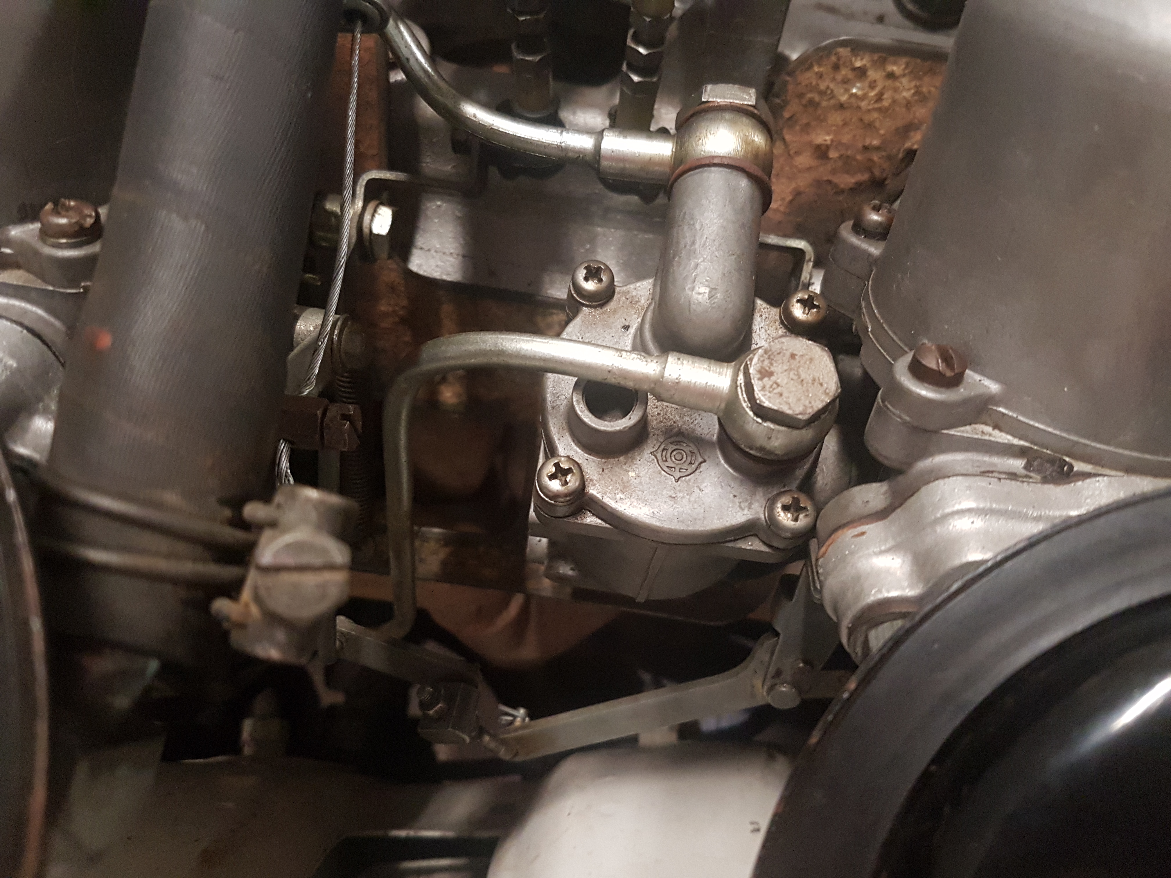

Hi Peter,
I wonder if the carbs were situated like this when you took the engine out?
The petrol bowles should both be in the middle between the carbs?
Gr Dick

Hi Dick,
Remember this is a PR90 and not a PR91 so they could have done things differently for the 90. I have attached some pictures of the engine in the car and after of the carbies on the bench when they were out, you will see that the factory fuel line is set up for the bowls to be where they are. I do not believe they have been taken apart before I got to them.

Posts: 95
That looks original indeed, Hitachi probably had 1 type of SU lookalike carb then.

Hi Dick,
Had a look at some more pictures I had on file and it looks like some if not all PR91 had their carbies the same way as my PR90. I have attached a picture of Kerry Bruty's engine bay in his PR91 and that all looks factory original.

Posts: 95
I ve never seen this layout of carbs in Holland. Always the bowles in between. It must be the age of the car: we do not have such an old model with twin carburettor. The metal pipes on the bowles for petrol overflow are metal too and go where to?
We have them in rubber and they go straight in to the carb air intake in case the float is not working properly.
There is always something to learn after all these years. Like the other day I found out later type Sports and GT ‘s standard have a limited slip differential ...
Gr Dick

Sun Jul 18, 2021 3:26 am
I forgot to say that the "bowl overflow" pipes run down to near the "cross member, steering rack ..." and empty onto the ground......(I think maybe (going by a fuzzy original Sale Brochure picture) there was a short length of hose on the bottom of the pipe originally (I maybe wrong...)

Posts: 95
A bit more symmetry this way? One of the seven beauties ... ;)
I think the primary function of the hose, from bowl to intake, is to vent the bowl.
Second function: in case of flooding the engine will stall.
