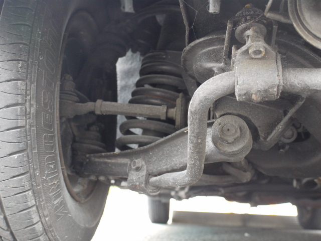

anybody got a source for these.
One of the most common rubbers to wear out on a Bellett. In the past I had NOS parts but they are long gone.
This must be a prime candidate for getting repro parts made as a group.
also, those rubbers on top of the inner mount link. The 'flat' ones onto the front cross member. I have seen something similar on a Fairlane in the past.

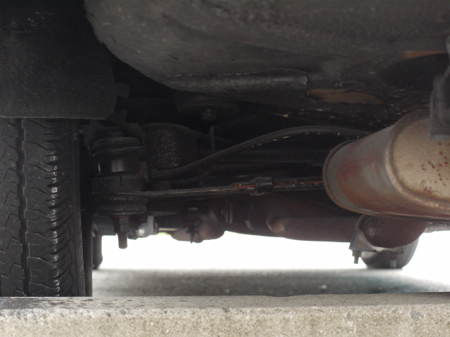

On the subject of rubbers, the rear spring end rubbers....
what top use there.. these ones look pretty far gone for example !

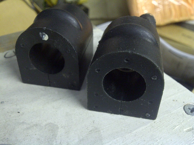

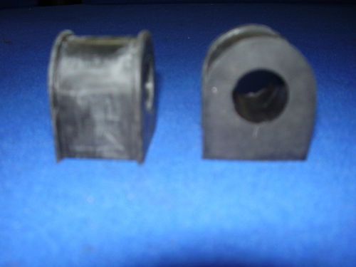

original on the left, home made Urethane on the right
Sat Jun 02, 2012 6:34 am
great job done there mate .....who can tell the difference .......cheers davo

anyone got an original new end rubber for the sway bars? or 2?
happy to pay postage and return it once i have made the mold.
need to borrow it for a week or so
happy to provide a few new Urethane pieces as payment for the loan.
PM me please if you can help out
