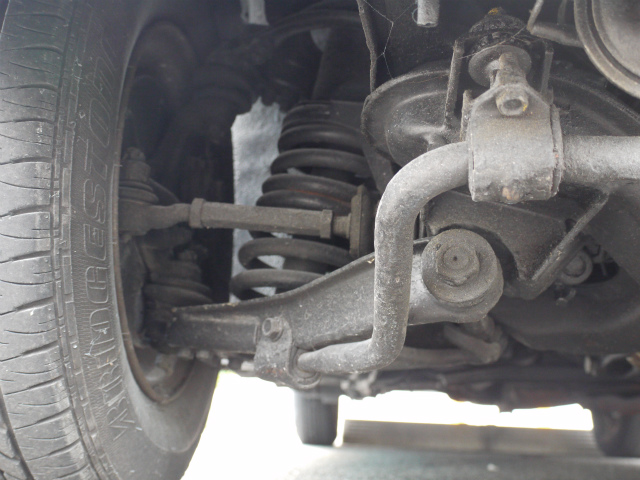

anybody got a source for these.
One of the most common rubbers to wear out on a Bellett. In the past I had NOS parts but they are long gone.
This must be a prime candidate for getting repro parts made as a group.
also, those rubbers on top of the inner mount link. The 'flat' ones onto the front cross member. I have seen something similar on a Fairlane in the past.

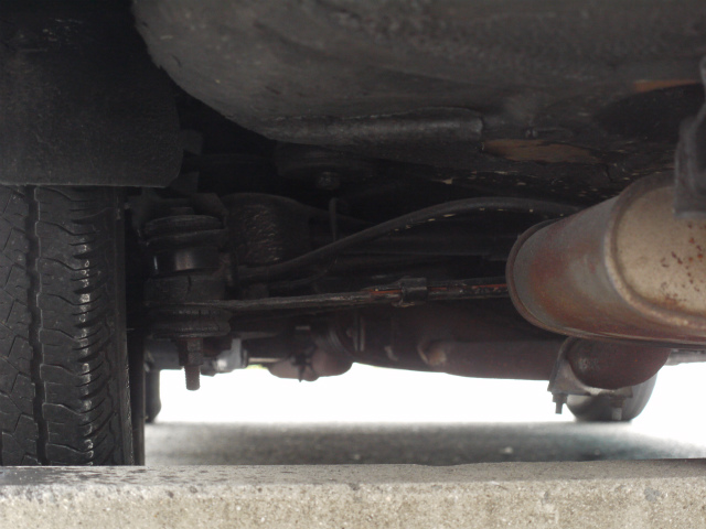

On the subject of rubbers, the rear spring end rubbers....
what top use there.. these ones look pretty far gone for example !

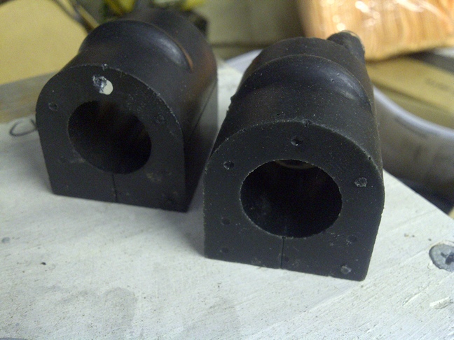

original on the left, home made Urethane on the right
Sat Jun 02, 2012 6:34 am
great job done there mate .....who can tell the difference .......cheers davo
Sat Jun 02, 2012 6:37 am
nice work oztoffa they look good!
Sat Jun 02, 2012 7:16 am
anyone got an original new end rubber for the sway bars? or 2?
happy to pay postage and return it once i have made the mold.
need to borrow it for a week or so
happy to provide a few new Urethane pieces as payment for the loan.

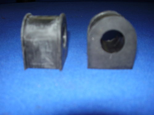

not sure if these might fit but since you guys are up that way, worth a look ?
http://www.ebay.com.au/itm/251097351905?ssPageName=STRK:MEWAX:IT&_trksid=p3984.m1423.l2649
$10 / pair
