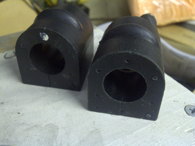

original on the left, home made Urethane on the right
Sat Jun 02, 2012 6:34 am
great job done there mate .....who can tell the difference .......cheers davo

anyone got an original new end rubber for the sway bars? or 2?
happy to pay postage and return it once i have made the mold.
need to borrow it for a week or so
happy to provide a few new Urethane pieces as payment for the loan.
PM me please if you can help out
