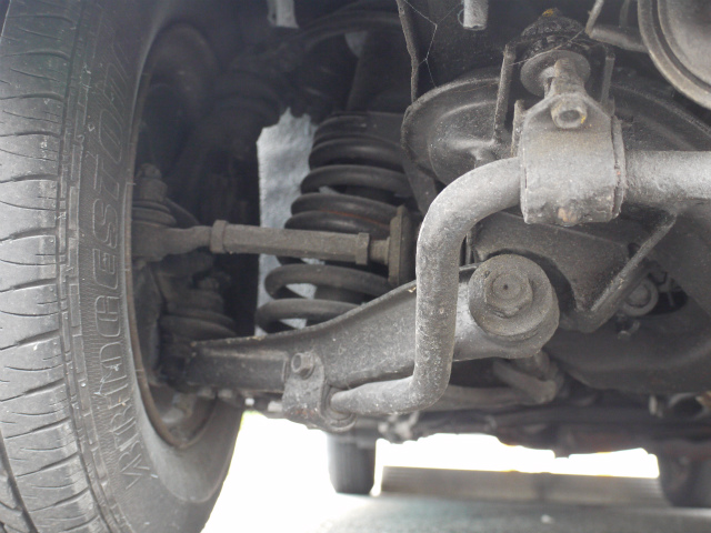

Sway bar end rubbers:-
anybody got a source for these.
One of the most common rubbers to wear out on a Bellett. In the past I had NOS parts but they are long gone.
This must be a prime candidate for getting repro parts made as a group.
also, those rubbers on top of the inner mount link. The 'flat' ones onto the front cross member. I have seen something similar on a Fairlane in the past.

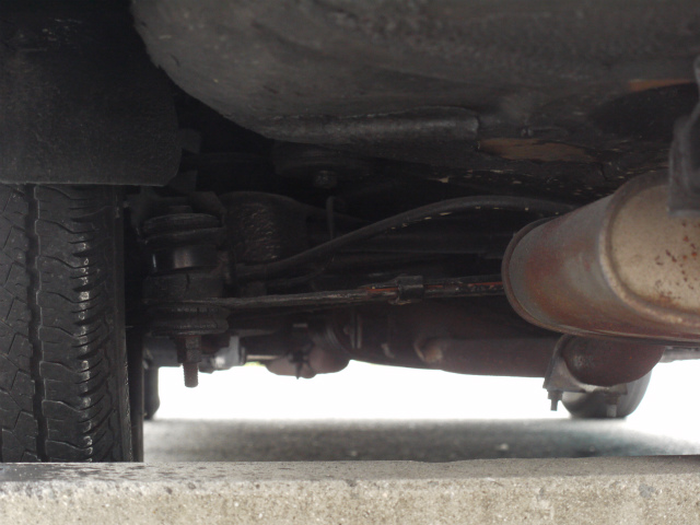

On the subject of rubbers, the rear spring end rubbers....
what top use there.. these ones look pretty far gone for example !

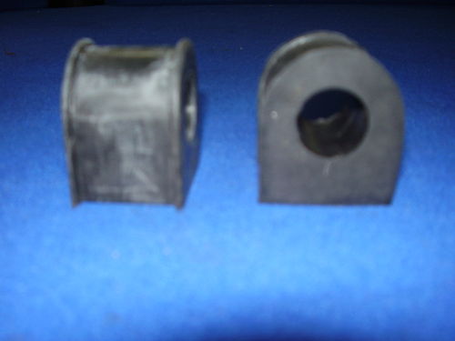

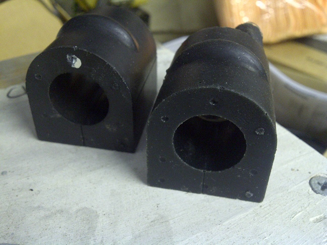

original on the left, home made Urethane on the right
Sat Jun 02, 2012 6:34 am
great job done there mate .....who can tell the difference .......cheers davo
Sat Jun 02, 2012 6:37 am
nice work oztoffa they look good!
